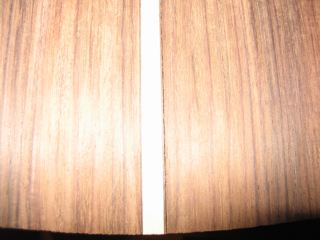

Hey guys,
I have a smaill hairline crack next to my backstrip and was wondering what
the best way would be to repair it. Thanks.
Ross
PostPosted: Sat Apr 08, 2006 4:35 pm
Do you have the back graft on yet?
IF you don't it might just pop apart for a reglue. If you do, super glue or Cyanoacrylate would do if you can pull some tape across the separated join, tightly. Good luck.
PostPosted: Sat Apr 08, 2006 4:50 pm
Hey Bruce, I PM'd you.
Ross, as Bruce said, wick in some HHG or med CA and tape it closed. You can run the tape overlaped on one edge right over to the other to apply the presure, or you could just put it in the go bar deck with the show face up in the 25' dish and put a few gobars on it to close up the crack.

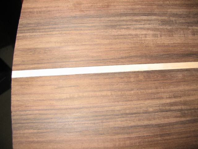

PostPosted: Sun Apr 09, 2006 12:38 am
Hi Ross,
Thanks for sharing pics bud, i'll be sending you some positive vibes for that repair! What Bruce and Rod said, they know better than me!
Keep us updated on this!

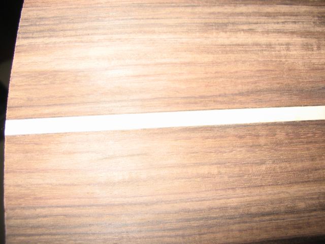

PostPosted: Tue Apr 11, 2006 1:56 pm
Joined: Tue Mar 21, 2006 1:00 pm
Posts: 133
Hey guys used all of your inputs and it turned out pretty well. Thanks again.

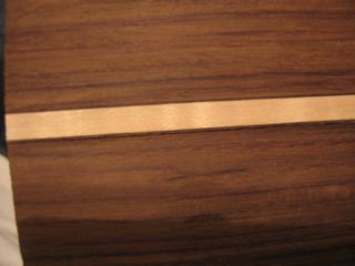

PostPosted: Tue Apr 11, 2006 3:10 pm
Great repair job Rossy!
Way to go bud, build on!
Very Happy for ya!
PostPosted: Tue Apr 11, 2006 4:24 pm
Crack--what crack? Nice job!
PostPosted: Tue Apr 11, 2006 5:52 pm
Posts: 1075
First name: Coe
Last Name: Franklin
City: Decatur
I don`t see no crack...
PostPosted: Tue Apr 11, 2006 6:01 pm
Great job Ross, Invisible.
PostPosted: Tue Apr 11, 2006 6:11 pm
Posts: 133
Thanks guys. I really couldn't have done it without ya'll.
Ross
PostPosted: Wed Apr 12, 2006 4:53 am
Hey! what happened?
its a miracle.....
